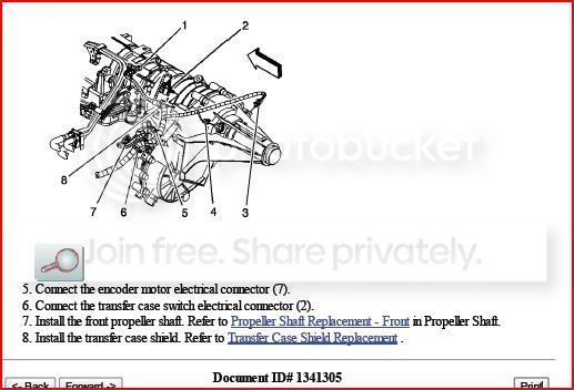

Here are the procedures, I can only pull to a 2005, but the steps are about the same. You'll need to verify which case you have.
NVG 246-NP8
NVG 263-NP1
