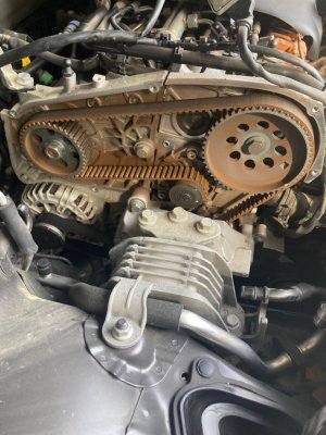

    Well, the "Change Timing Belt" message popped up on my Cruze once I hit 100k. So with 102k miles I got it changed. There is a really good video on Youtube that really helped. I was able to change it out with the help of a friend in just under 3hrs. Once I got the belt off and was able to bend it backwards, there was hardly any cracking in it at all.
    While it was up on the Quickjack I also changed out the transmission fluid. I did 2 drain and fills. It takes 3qts at a shot so I changed out 7qts. It has had AMSOIL in it since 10k miles so this was a nice refresh. Also it runs at 220°F, so that hot in a transmission I like to keep the fluid fresh at least every 45 to 50k miles.

    It wasn't bad at all. Once the mount was out of the way there was plenty of room. The water pump was super easy. Having a friend really helped with keeping the belt in place as I ran it around the other gears. No sweat next time for sure.
