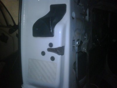

I'm not sure if the diagram in the pdf is what I have. I think its held on by rivets, but I want to make sure I got everything right before I start drilling away.

Here are some pictures I took. Do I remove all 3 rivets to get the actuator out?
Those will remove the entire latch assembly. I don't think you need to do that to replace the actuator.
:werd:
It's very likely you will need to drill rivets out, just not those. Look around for the actuator inside the door with a mirror and a light.
