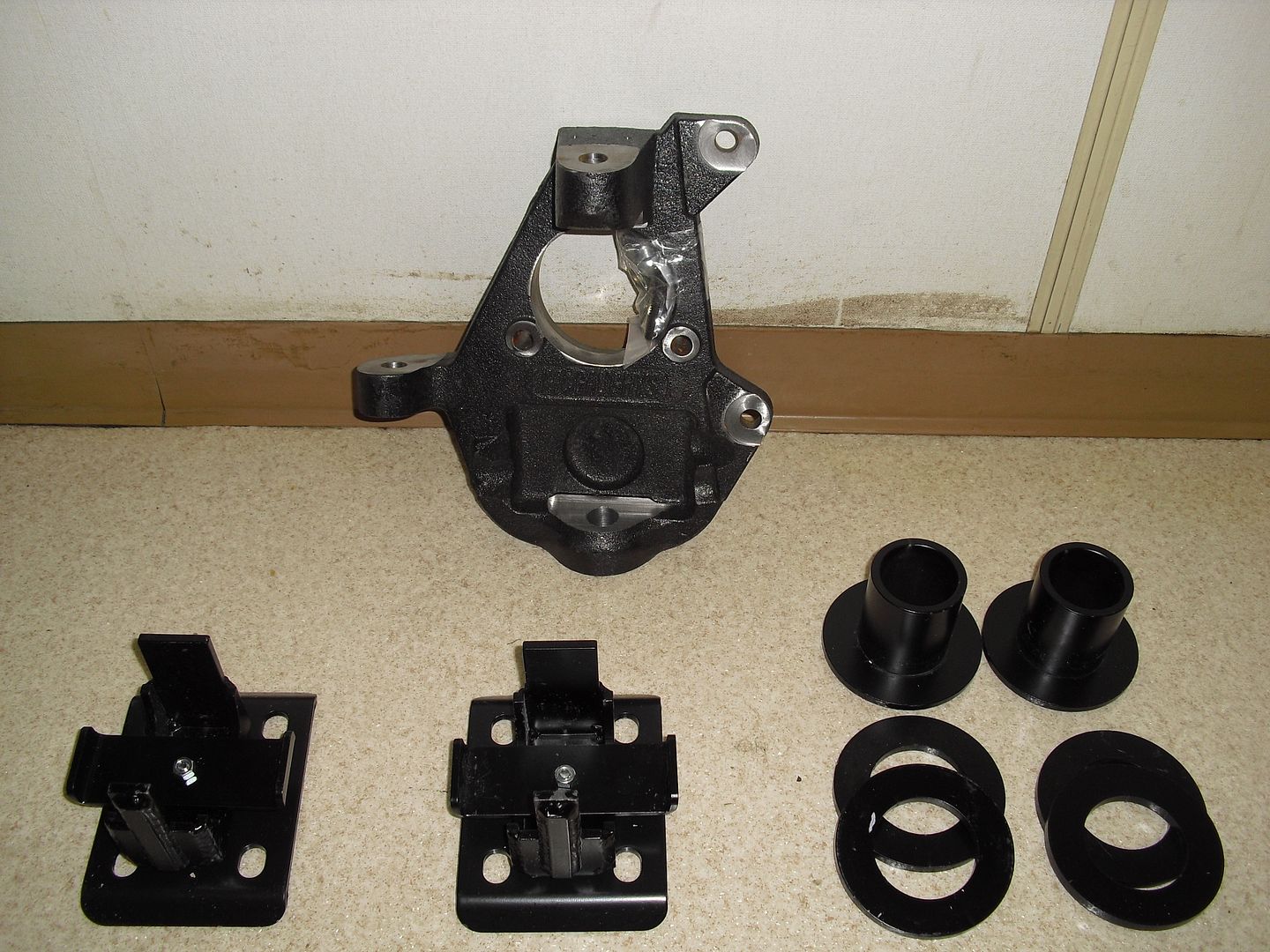

Drop kit from McGaughy.

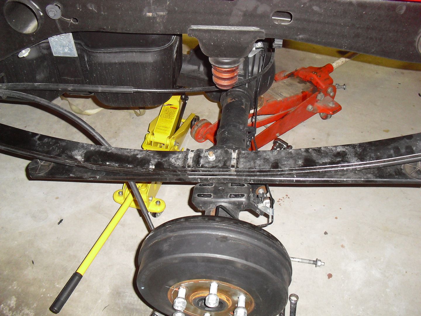

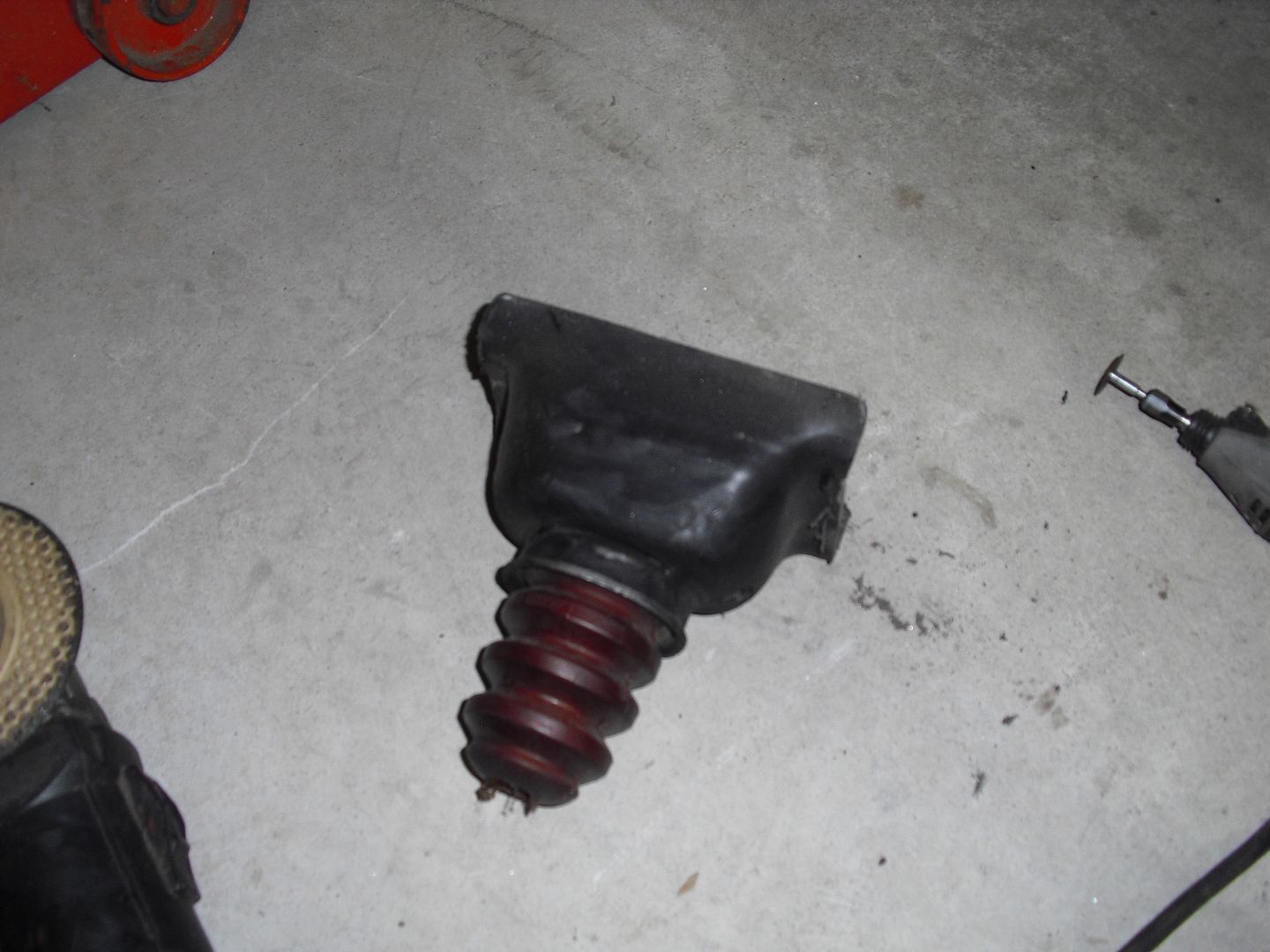

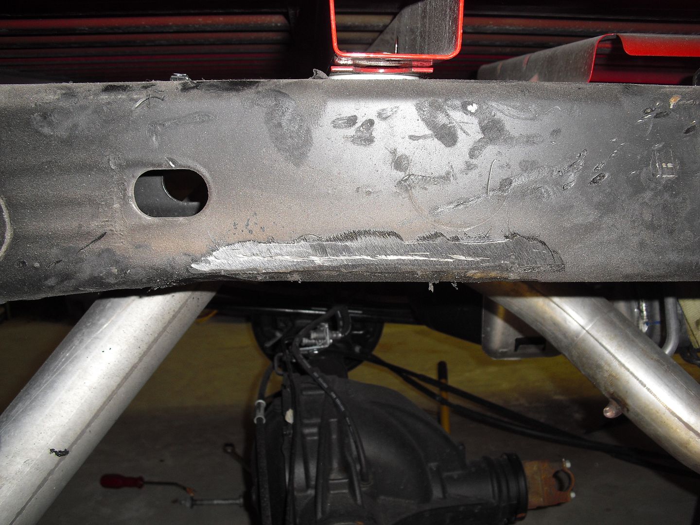

Remove the U bolts on the driver side springs and lower the diff down out of the way. Now with a grinder or cutoff wheels remove the factory bump stops brackets.
With both bump stops removed, slide the diff out to the passenger side of the truck a couple of feet. Loosen the front driver side spring bolt, remove the rear driver side shackle bolt and swing the spring over and down to the floor. ** The only way to get the front spring bolt out is to drop the tank. I decided rather than wrestle a full tank of fuel out from under the truck I would just remove the rear diff**

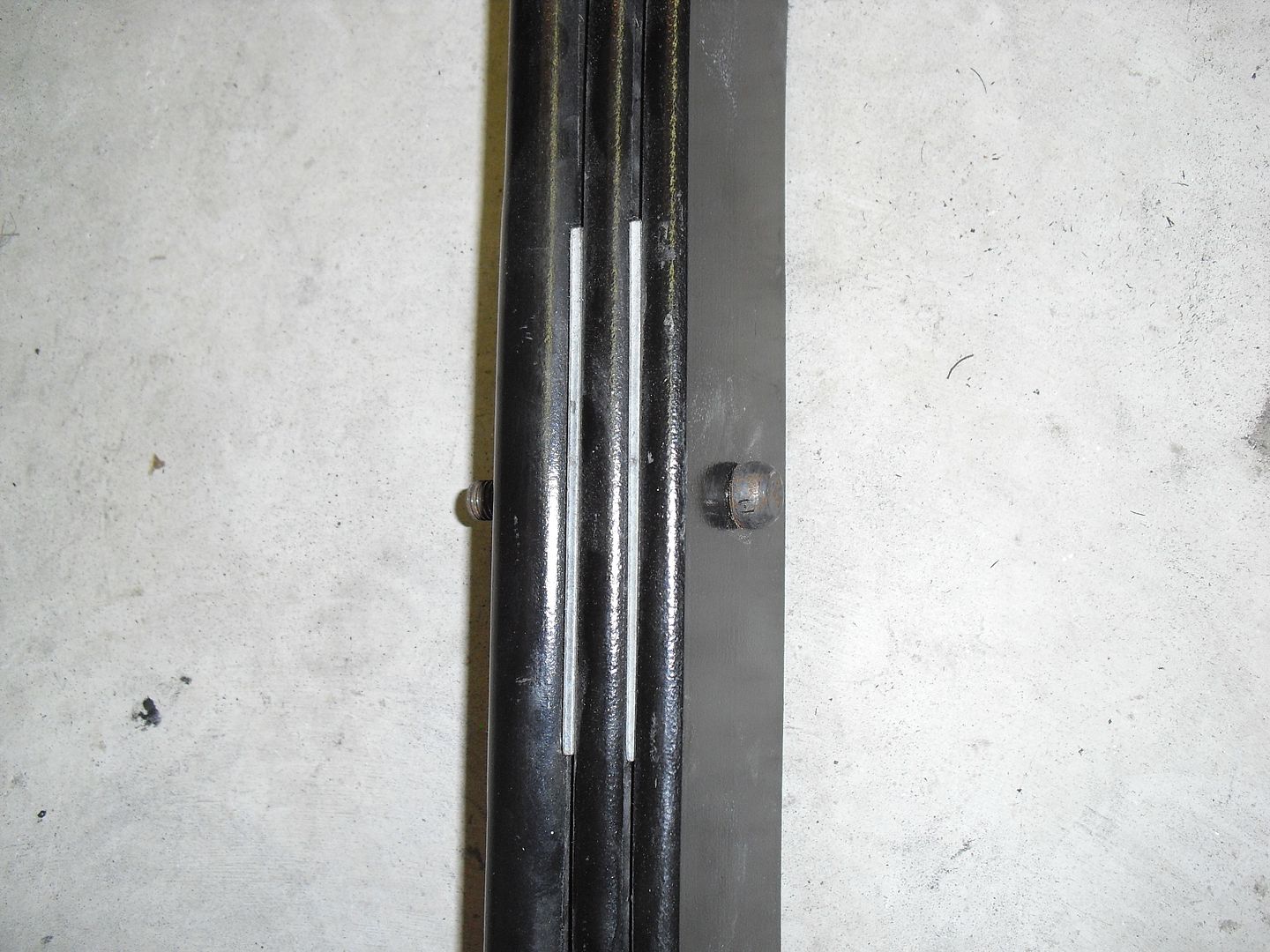

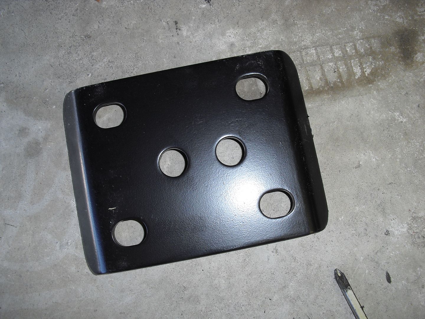

Remove the bolt and crinkle plate in the spring pack and flip the pin over. Discard the crinkle plate, you will not need it with the flip kit. It should look something like this when done.

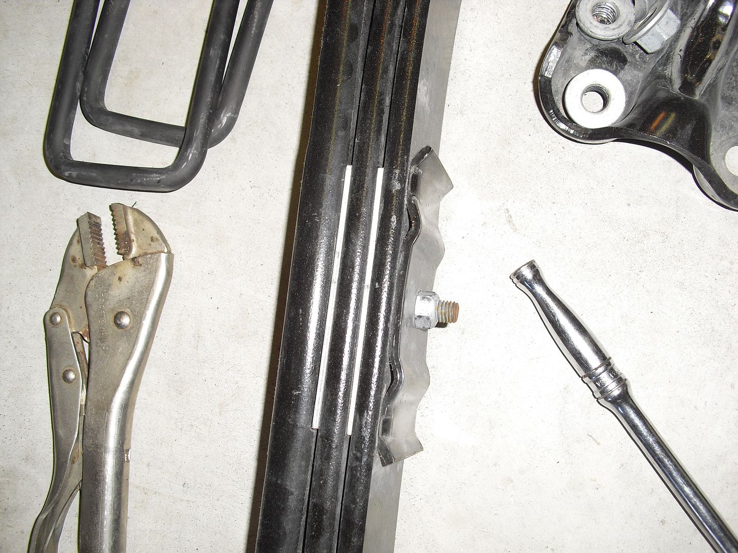

Pull the bolt out of the passenger side spring pack and flip the bolt and discard the crinkle plate.

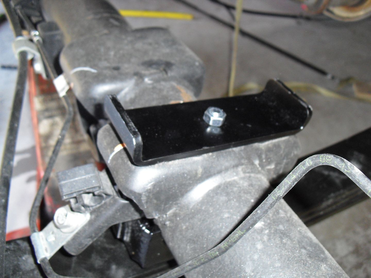

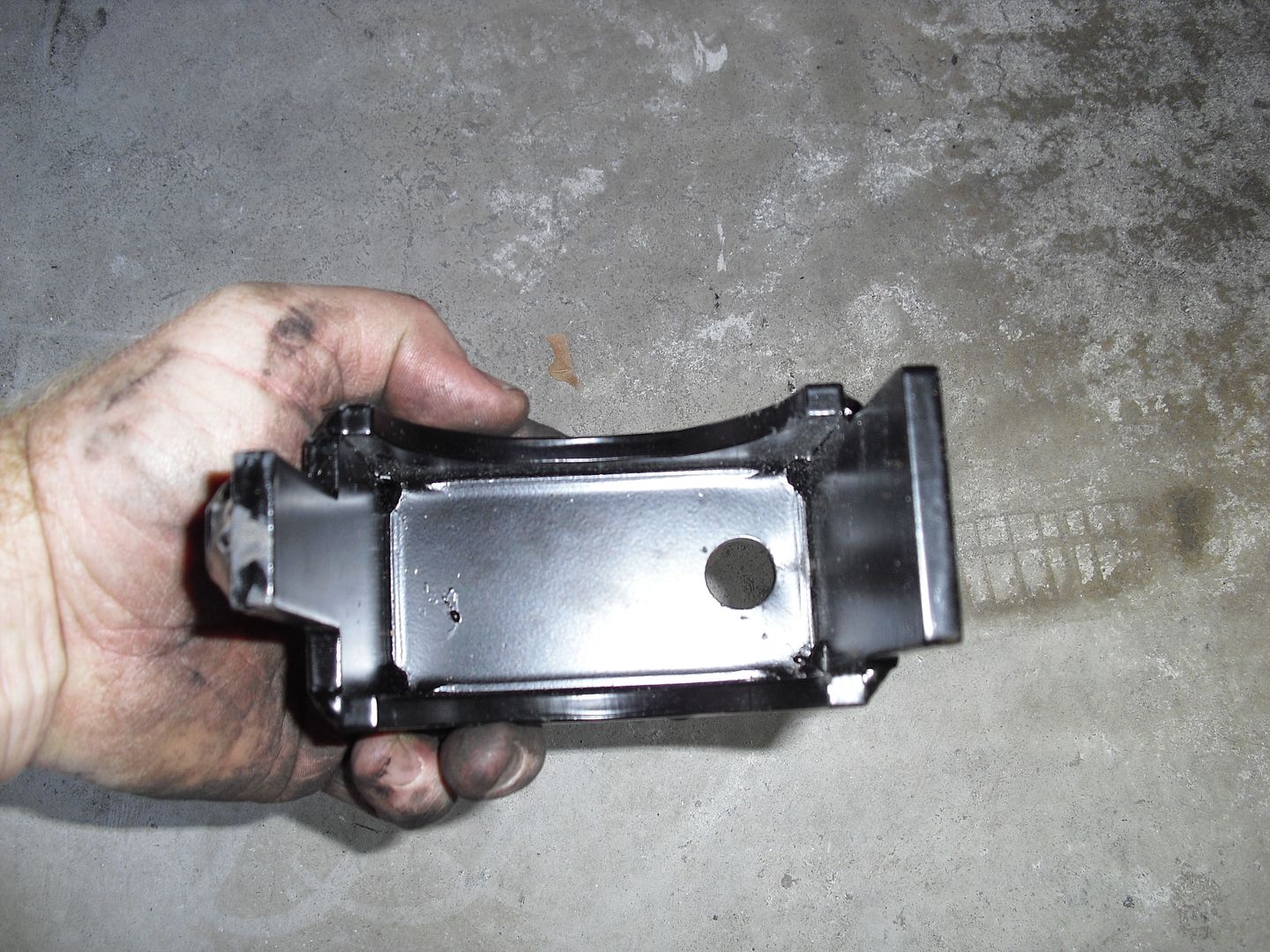

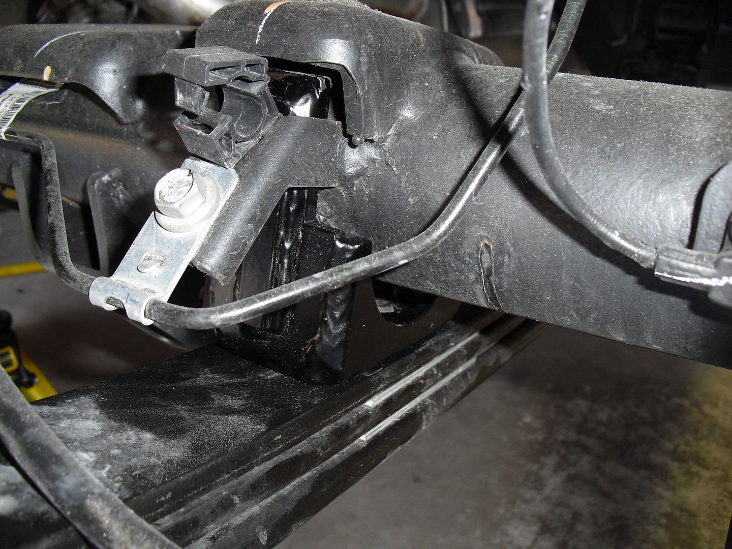

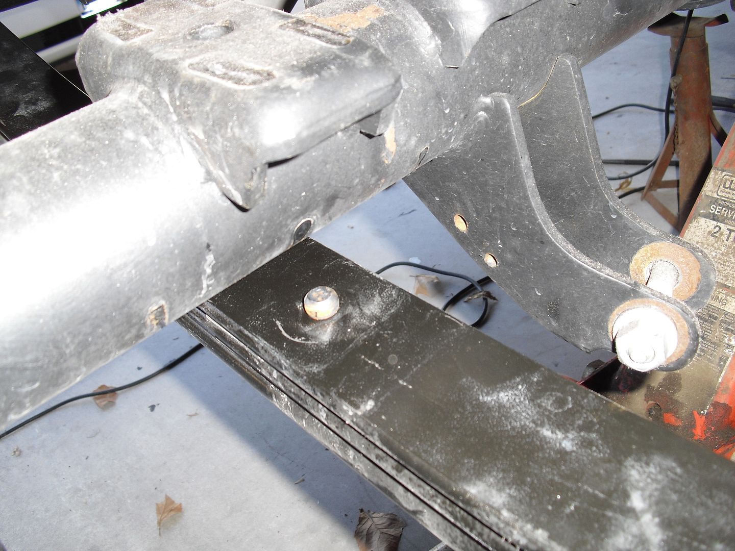

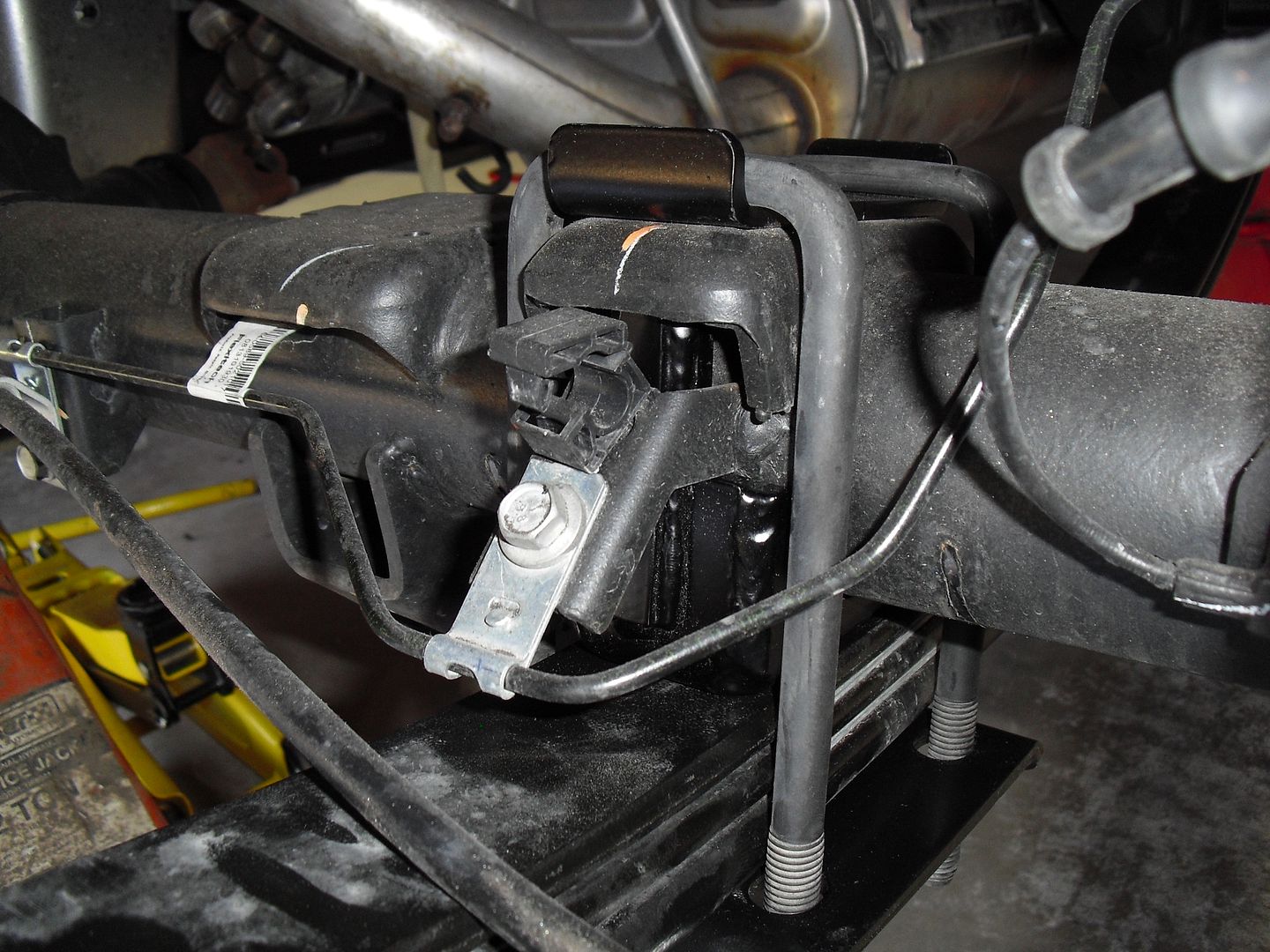

Re install the passenger side spring pack. Locate the flip kit saddles, the hole in the bracket will go toward the front of the truck. It will sit over the pin in the spring pack and locate the rear diff correctly.
Here is a shot of the saddle in place, looking from the rear. The way these things are made I don't believe you could put them in backwards since the tang on the front is wider and wouldn't fit between the brake line brackets.

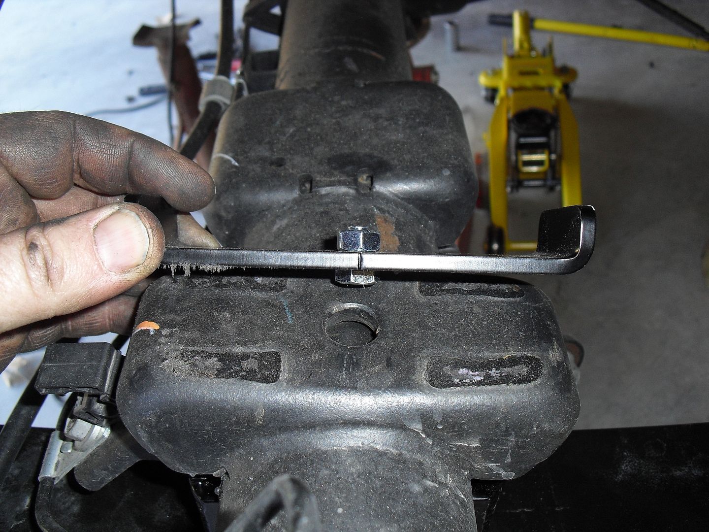

Now lower the diff down onto the saddles and locate the flat piece with the bolt in the center. This piece locates into the original spring perch and helps keep the U bolts in place.
Now get the lower retaining plate and U bolts, make sure the offset hole in the retaining plate goes forward. Place the forward hole over the end of the bolt sticking out of the spring pack.
Install your U bolts.
Now reconnect all lines and cables, snug up the spring bolts and tighten the U bolts. Re install your driveshaft and shocks, put the wheels on and lower the truck to the ground. Now tighten up all of your spring and shackle bolts. Bleed your brakes and have a beer.
