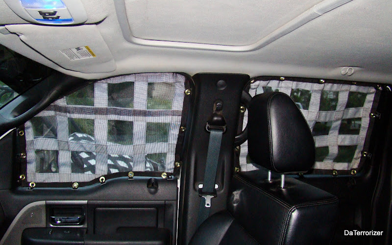

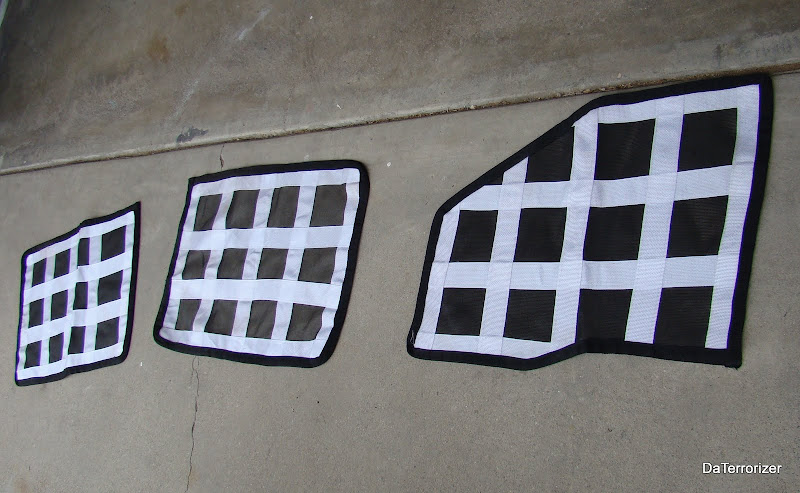

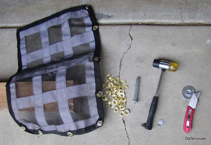

After I finished designing my window net and my wife finished sewing it together,

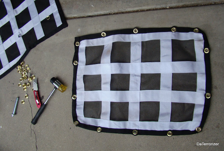

I added the Grommets

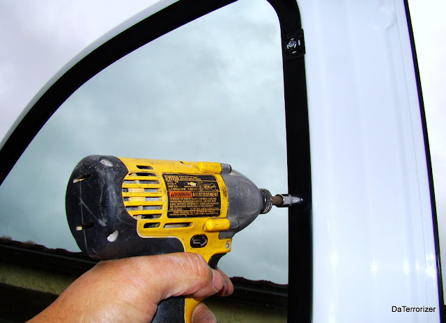

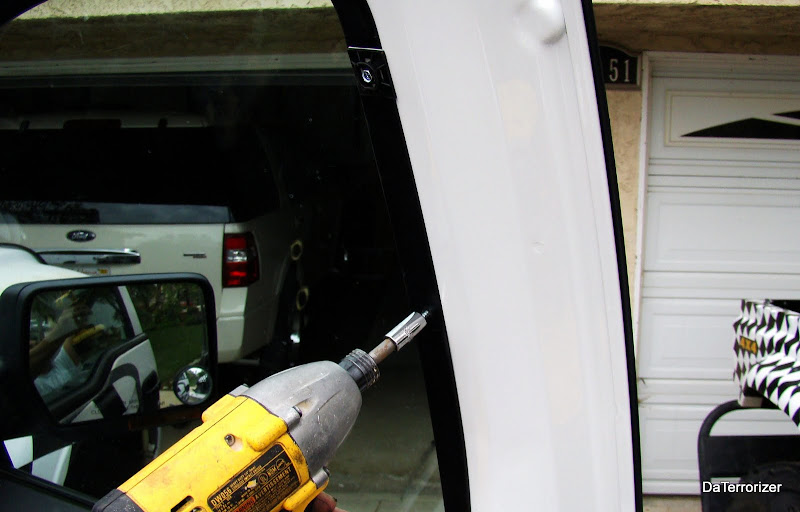

Then crazy got the best part of me and I made a bunch of holes around my windows

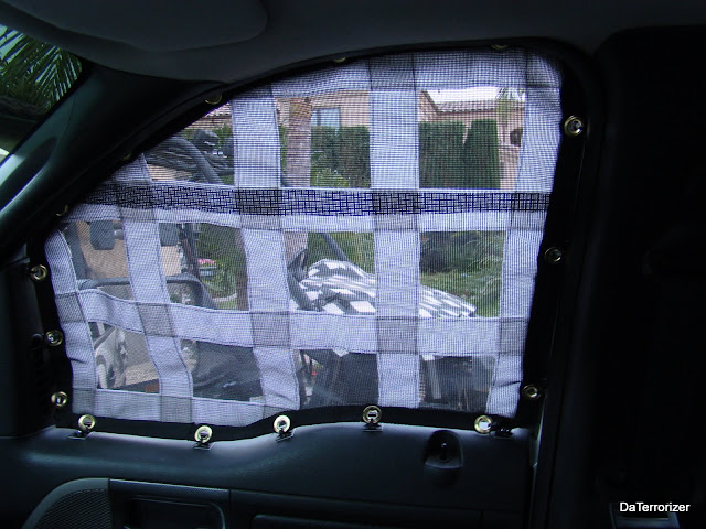

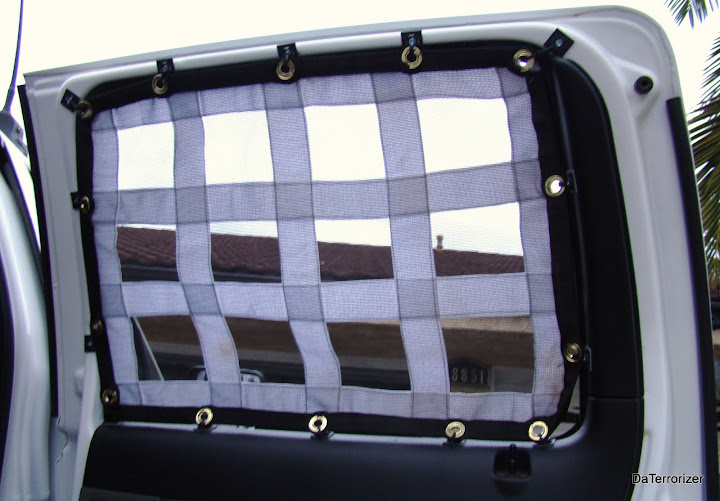

Then I took zippy ties to secure the net on my window openings.

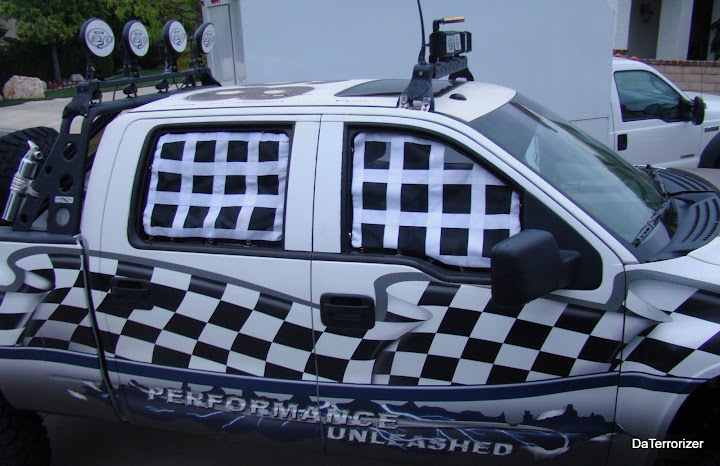

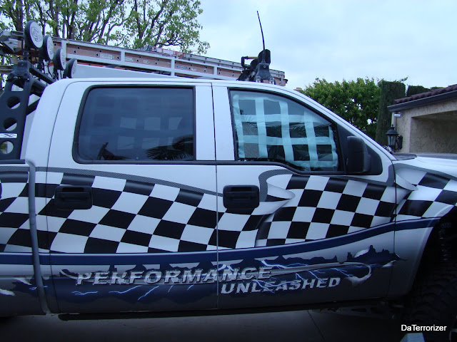

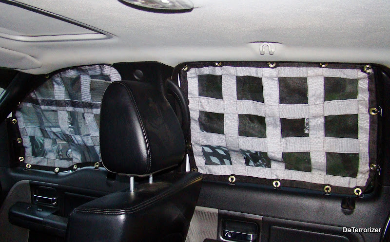

With the windows up
With the windows down

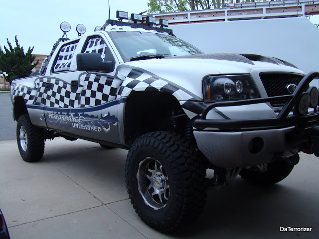

The purpose of the window net is to be able to keep my windows rolled down and stop most of the dust from entering the truck, branches form slapping me or my passengers or being hit by flying pebbles when running the trials, it is intended for off road use only.
