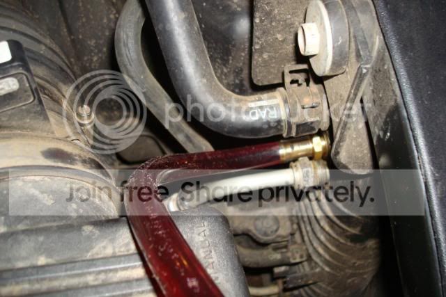

One Transmisson cooler line fitting with a hose barb. I found one at O'Reilly's for 5 bucks.

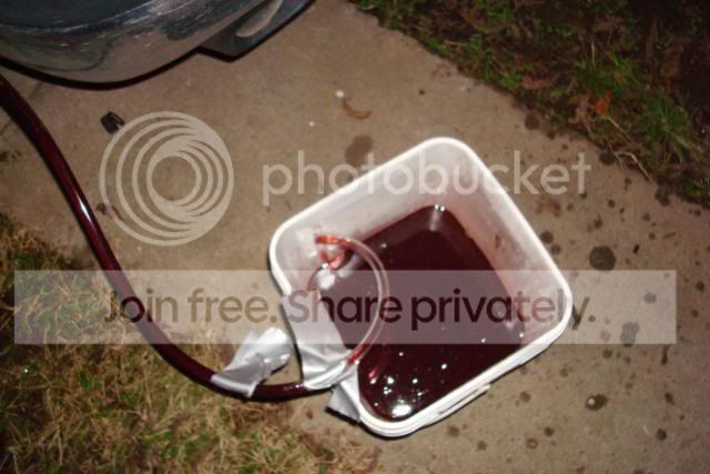

You'll also need some clear tubing to connect to the barb fitting and run down to a bucket. I found some 3/8 inch clear tubing at Lowe's for 25 cents a foot. I used 6 feet to go from the barb to my bucket.

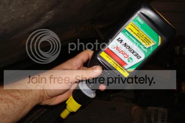

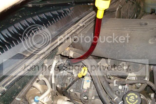

Next, after you get the pan and everything reinstalled fill it with 4 quarts of transmission fluid. I used Cstrol Dexron VI. You'll need either a transmission funnel or a hose that screws right onto the bottle (which is what I did).

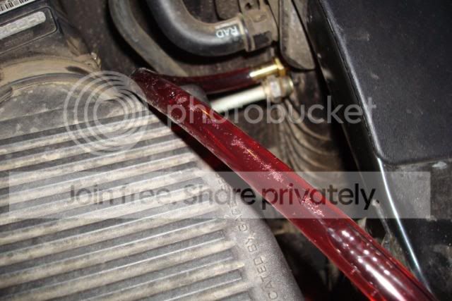

Now once you get it filled with 4 quarts, now install your barb fitting to the radiotor. Undo the top transmission cooler line from the radiator and screw in the barb fitting in its place. Then connect your clear tubing to the hose barb and run it down to your bucket. Now this next step, its very helpful if you have a sceond person to help you. You need to start the engine and let it run for a few minutes. You'll see the fluid pump thru the clear tubing and down into your bucket.
Once you start seeing air bubbles in the fluid going thru the tubing shut the engine off immediately. Thats why its helpful to have a helper in the driver's seat.
Now fill the transmission with 4 more quarts and repeat the flush procedure till you see air again. Then do it a third time with your remaining 4 quarts of fluid. Start it one more time and you should now see pure clean fluid running thru the tube.

I wish I would have thought to order mine early enough so I could have had it this weekend. :facepalm: So I guess all you need now is the barb fitting and some clear tubing and you are good to go. :thumbs:I found mine on the rack with all the nuts and bolts and door panel fasteners and stuff at my local O'Riellys. You can even write down the part number from the pic I posted to make sure you get the right fitting.
I'll have to look into mine a bit, I think mine has those quick connect lines. Don't remember for sure but I will look into it this week if I get a chance. If it does have the threaded ones like you have I'll get that number from your pic.
