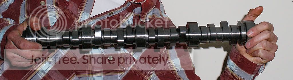

The cam I will be running was spec'd for my setup by Patrick Guerra.
Specs: 216/224 .561”/.568” 114LSA +4.

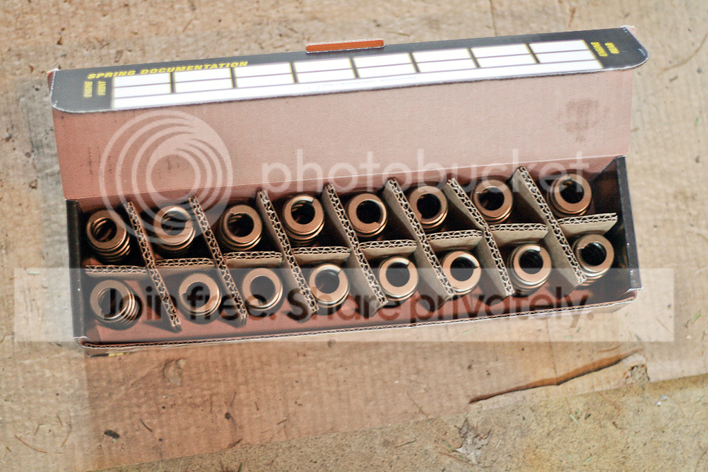

I'll be running the Comp 918 valve springs, and hardened pushrods. As of 12/16/09, I'm waiting for all of these goodies to arrive.
EDIT: I will actually be running the PAC 1518s, and selling the 918s. I just feel more comfortable with them, plus they give me some room should I ever go with a bigger cam.

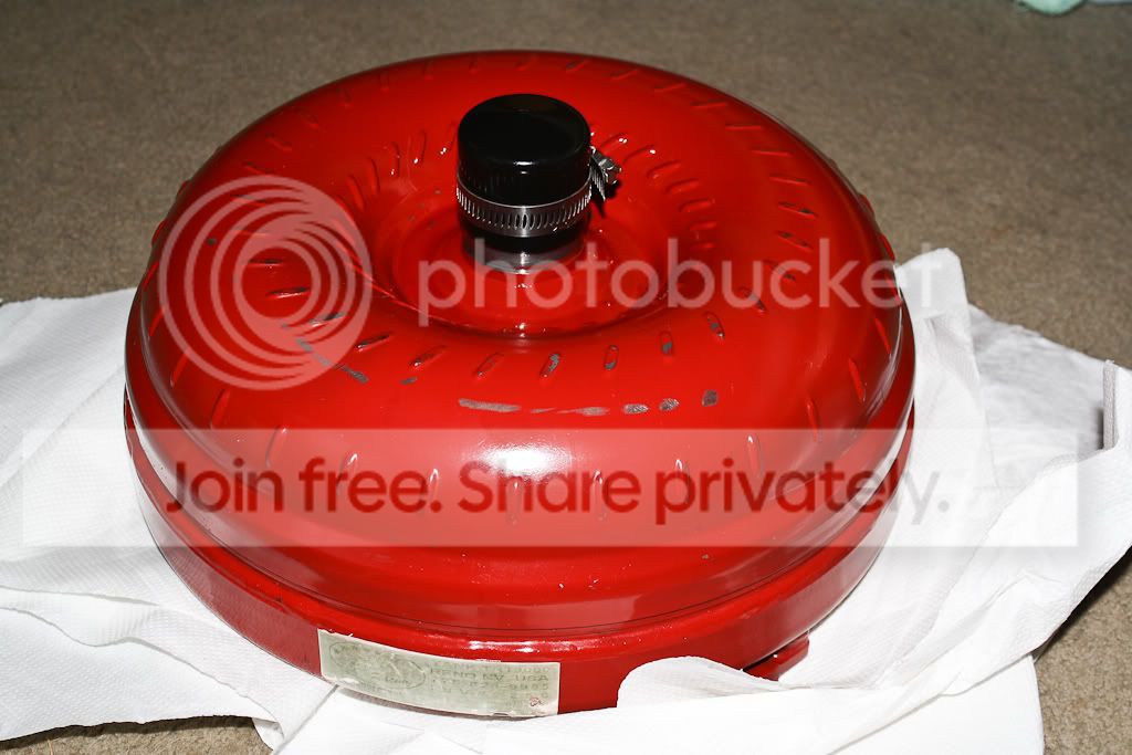

To accompany that cam, I will be running the Yank TT3000 torque converter. Obviously, it's got a 3000 rpm stall speed. I bought it with around 7,000 miles on it.

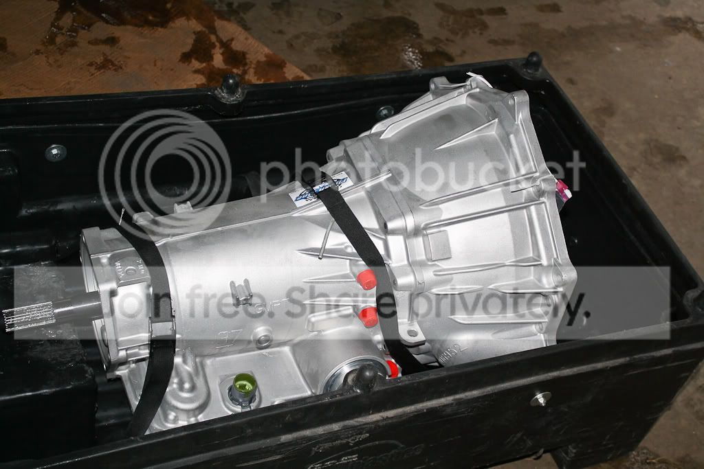

To handle all that, I'm going to run a built 4L60/65E, probably from either Performabuilt or Finish Line Transmissions. This won't be arriving until right before everything goes in the truck.

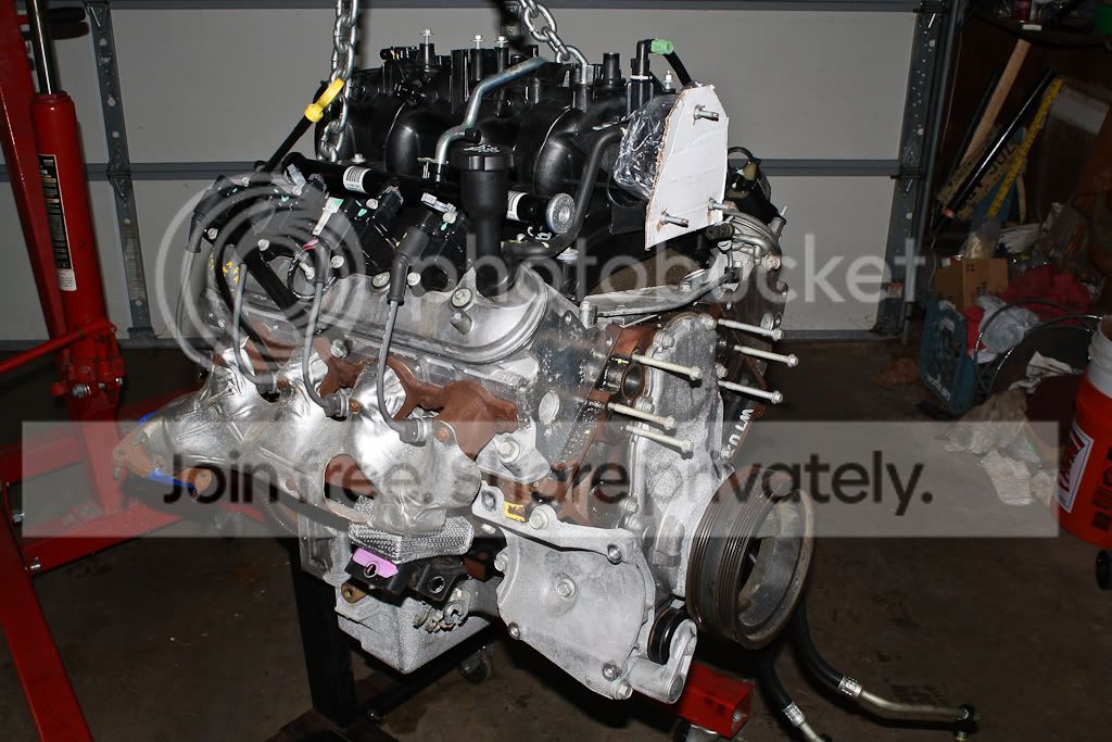

Step one: Teardown. Sort of. Ok, not really.

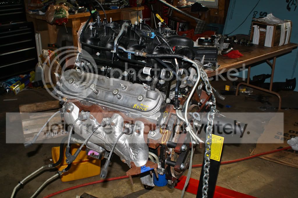

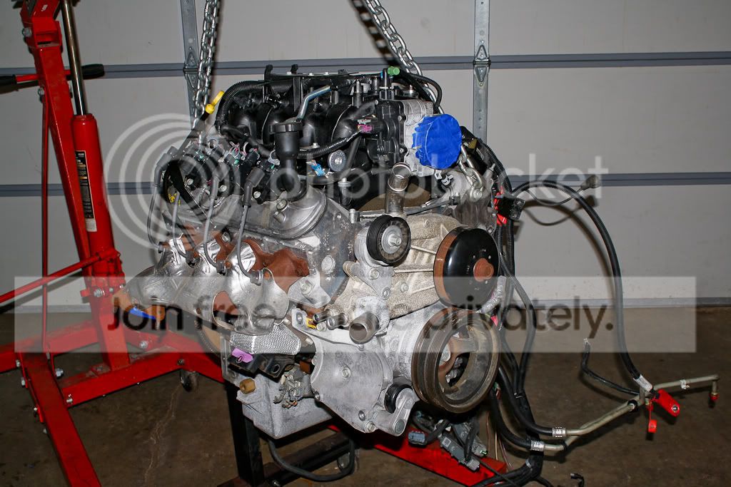

I guess you could say I got started tonight. Got the engine up on the stand (which I don't fully trust yet it's a bit more flexible than I'm comfortable with, that's why it's being spooned by the hoist for backup).

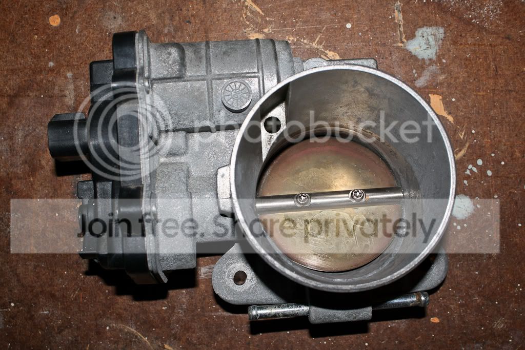

Then I pulled off the drive-by-wire throttle body, which I won't be using (look for it in the for-sale section soon).
Then I pulled off the water pump (in preparation for the cam swap). Then I got cold, and called it a night. Here's where I'm at now.

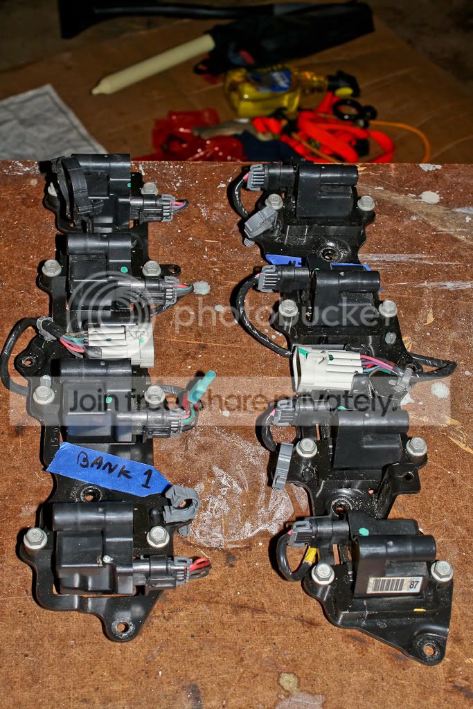

Now that the semester's over, I'll finally start pulling the drive-by-wire harness, and the coils off in preparation for the cam swap. Hopefully I'll get that done tomorrow.

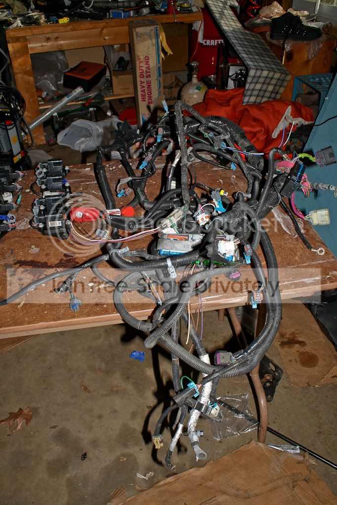

DV2000NJ
The Browmaster
7,492
Central NJ

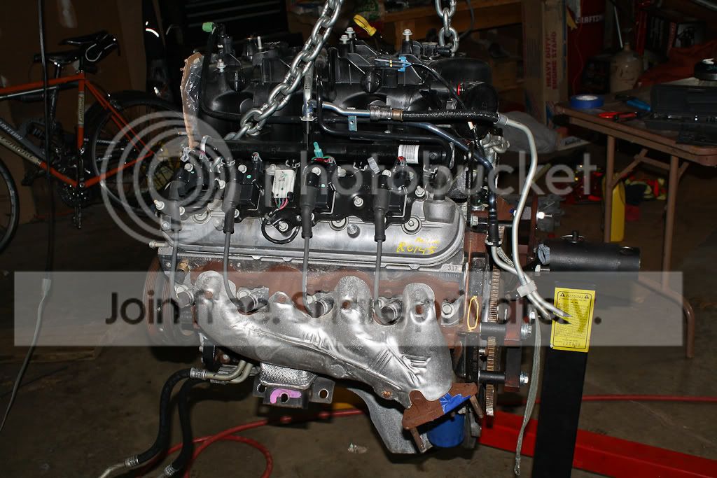

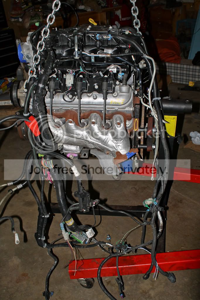

Pulled off the harness and coils today. Not a whole lot else to do until the cam and everything get here.
Pretty boring stuff.
From this:
To this:
To this:
Spaghetti?

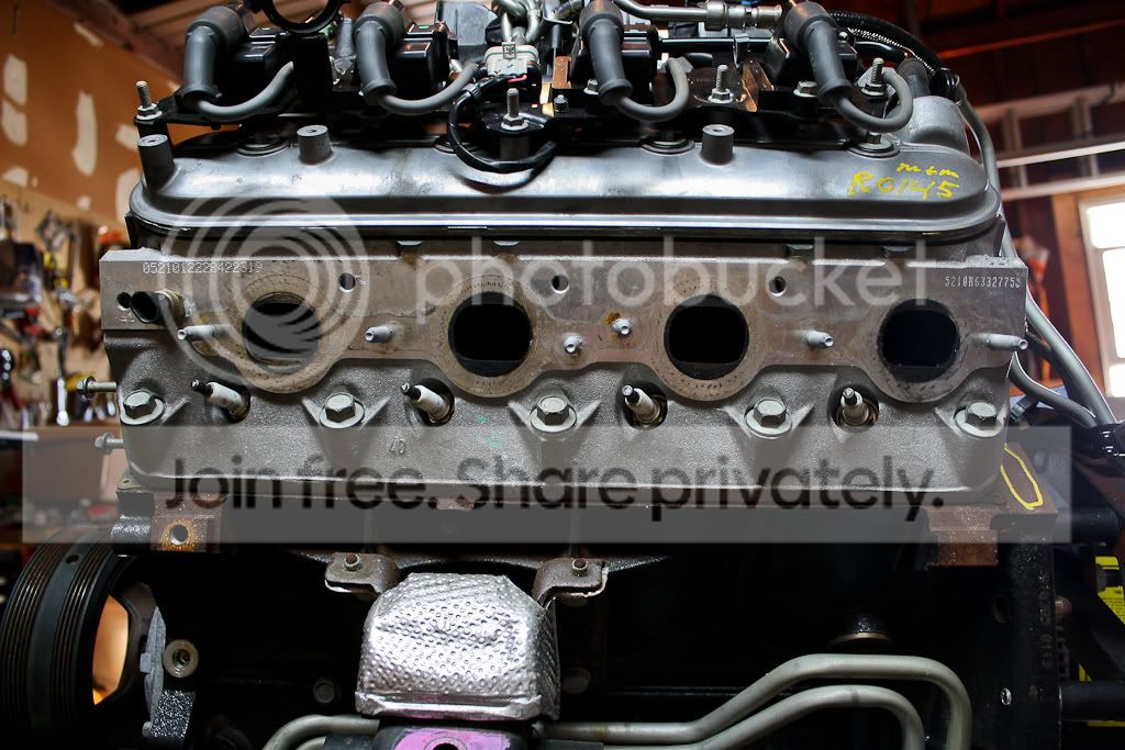

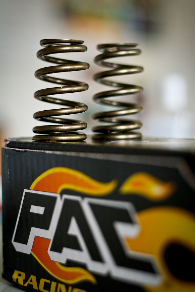

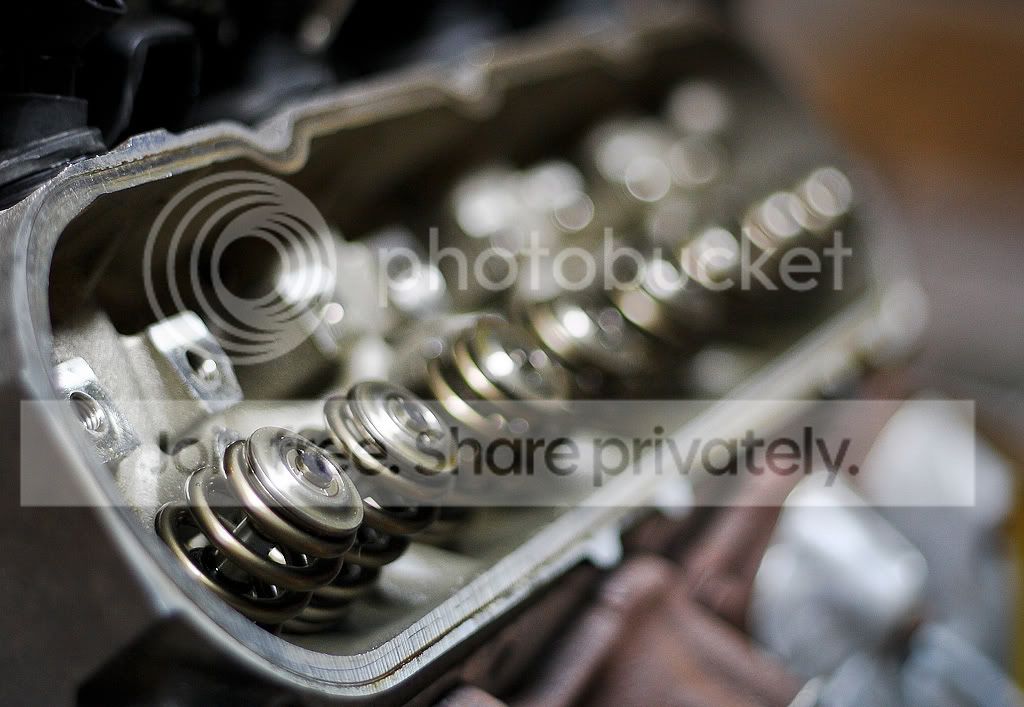

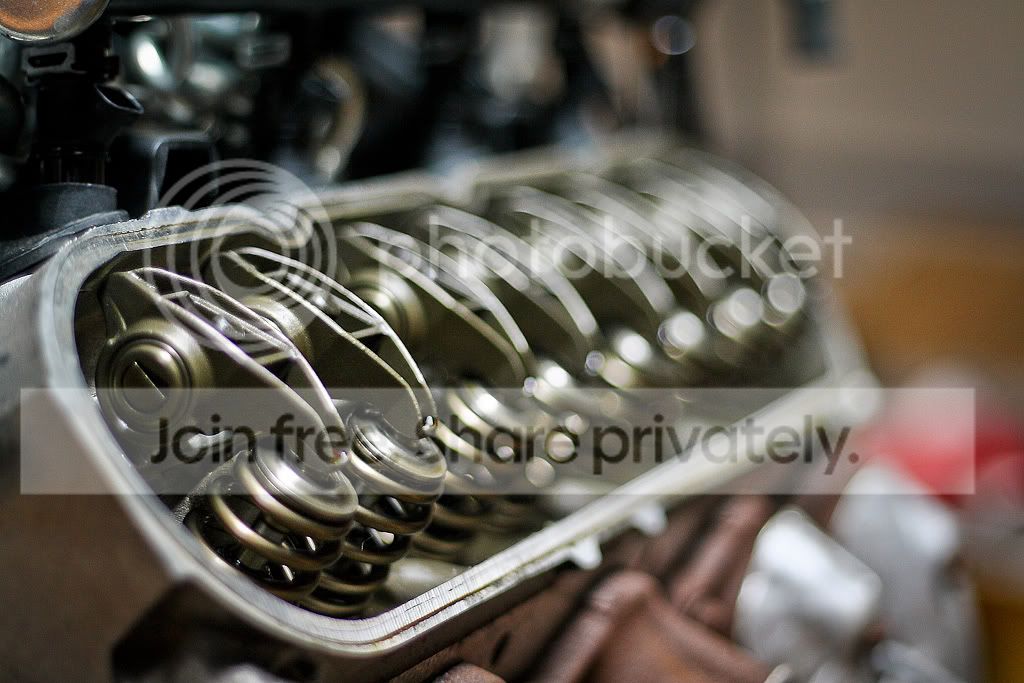

So I had these:

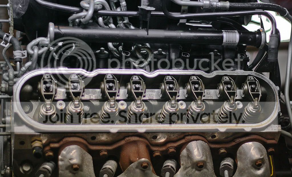

So I took off the valve covers and it looked like this:

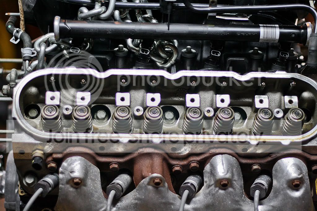

So I took off the rockers and it looked like this:

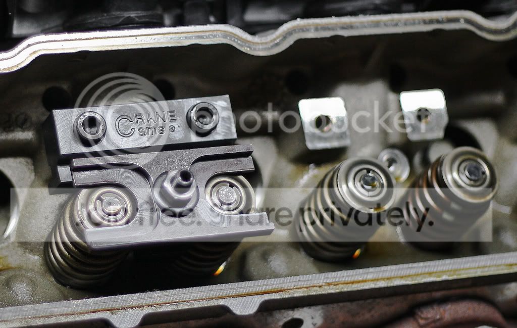

And then I used this:

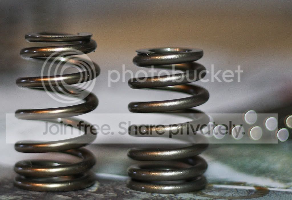

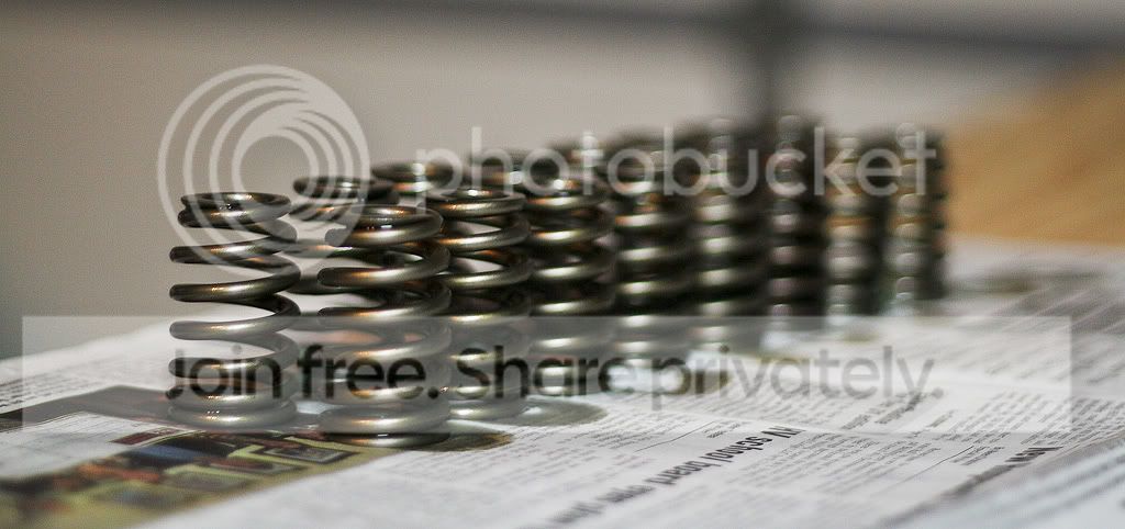

PAC 1518s on the left.
Old springs.
Ooh, pretty.
Overall, it went better than I expected. Took a little less than three hours to do everything. The Crane tool is a freaking lifesaver, literally almost half the work of a normal tool.

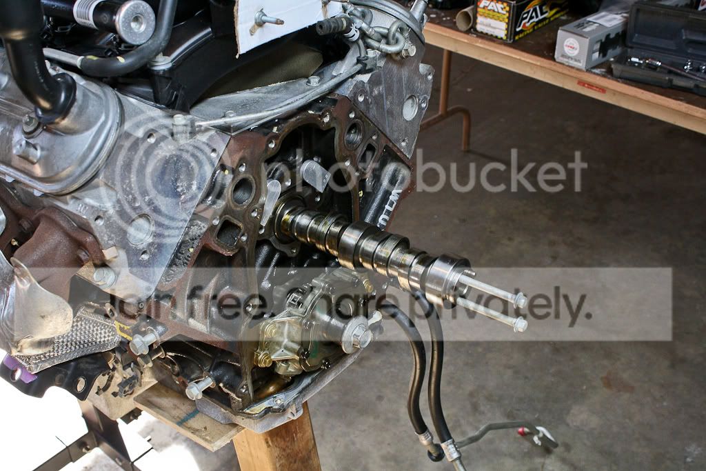

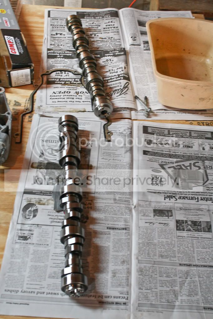

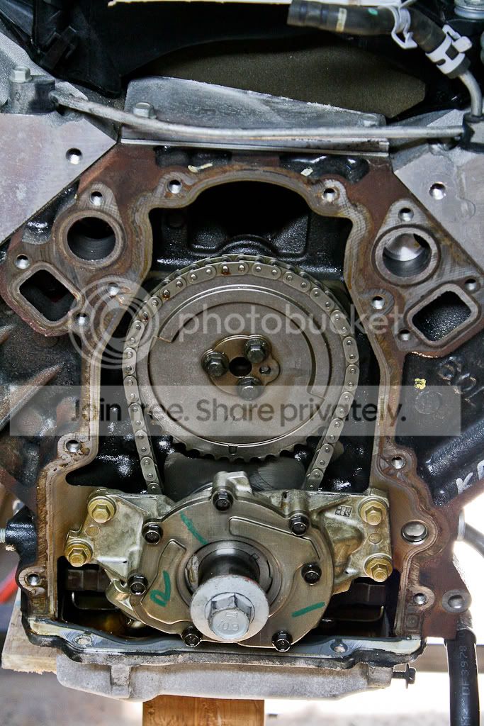

I now have a cammed 6.0 sitting in my garage. :D

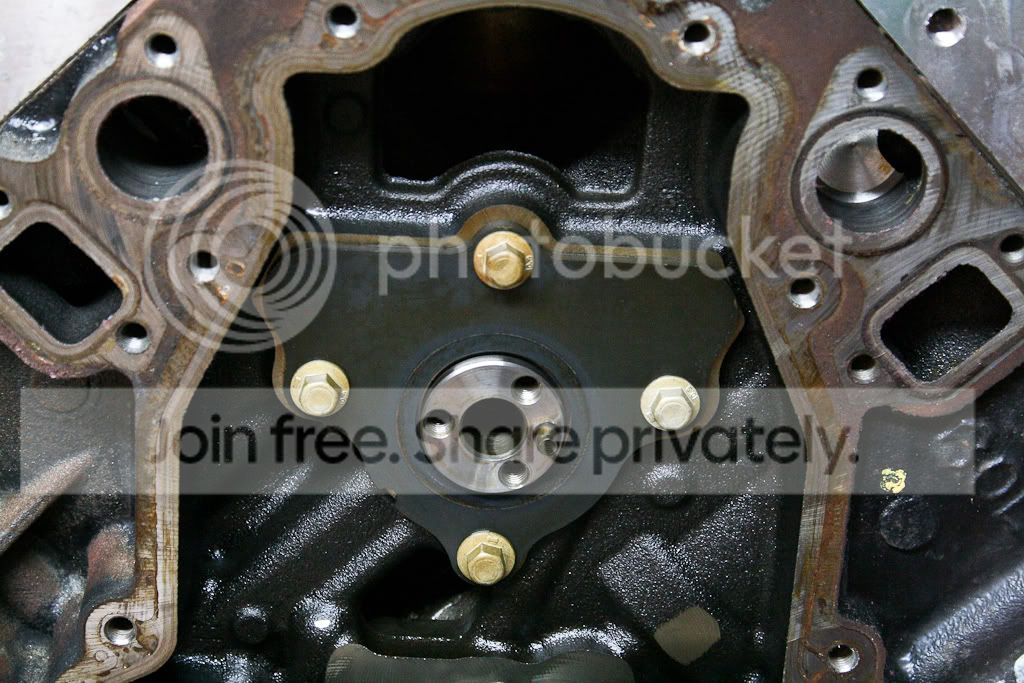

Timing cover off
Cam gear off, cam retainer plate visible

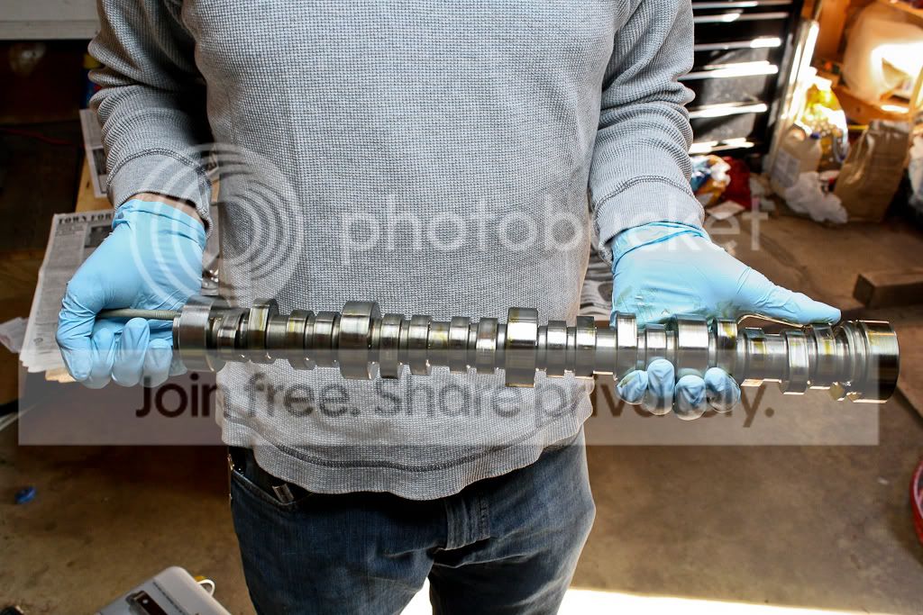

Old cam halfway out
Old cam
Old cam in the background, new up front
And... Then I forgot to keep taking pictures.
The pushrods are in, rockers torqued back down, harmonic balancer installed. Coils and water pump will probably go back on tonight or tomorrow, and then, we wait.

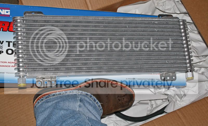

Tru-Cool 40k came in on Friday.
This bitch is HUGE (foot present for size reference :lol: :D).

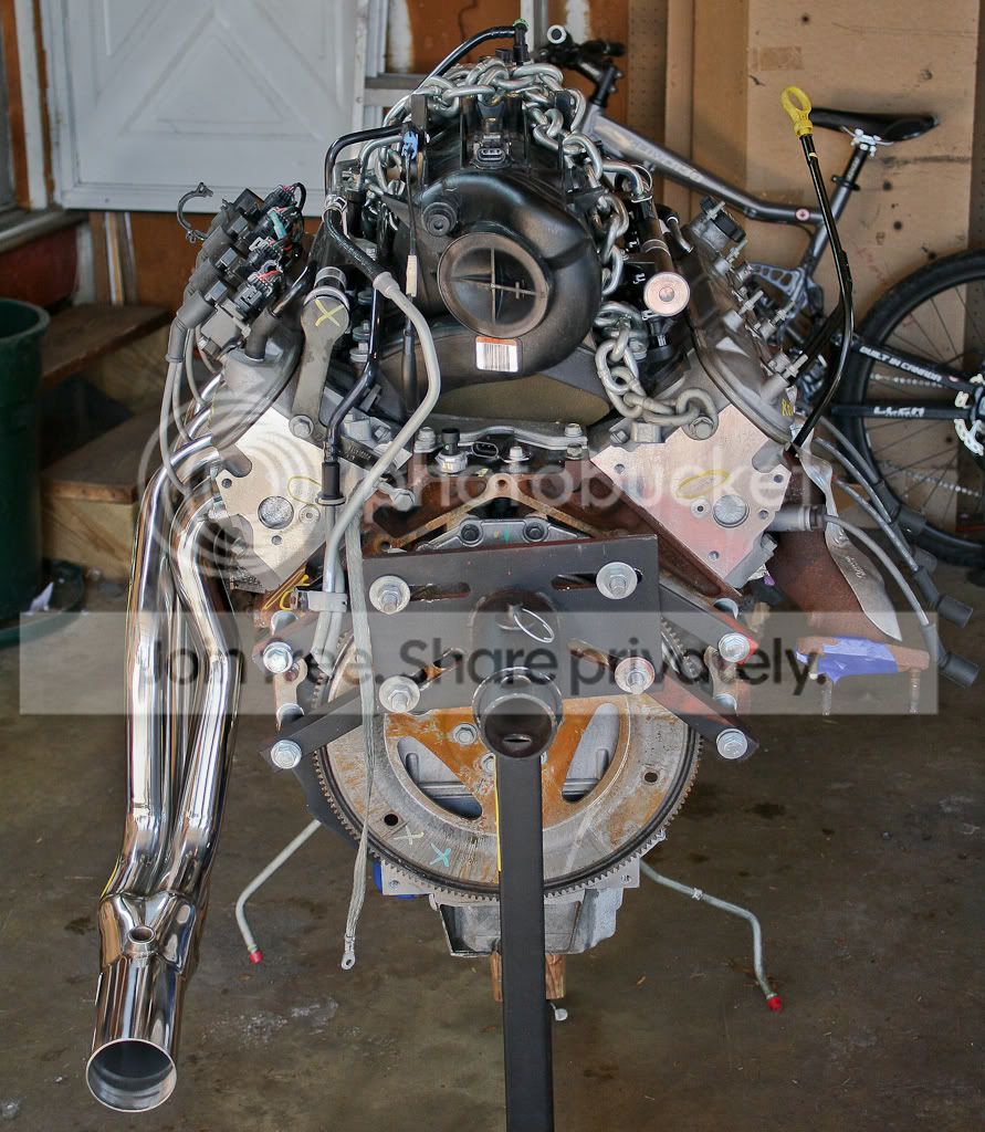

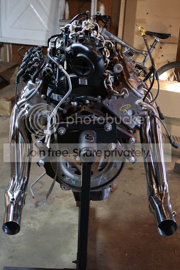

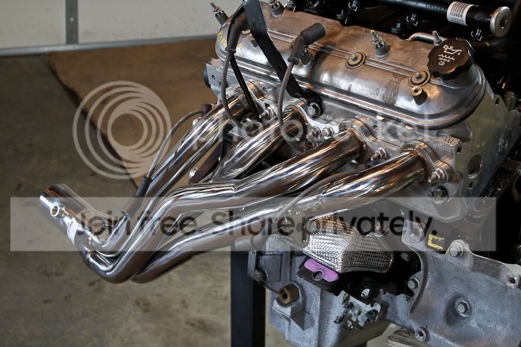

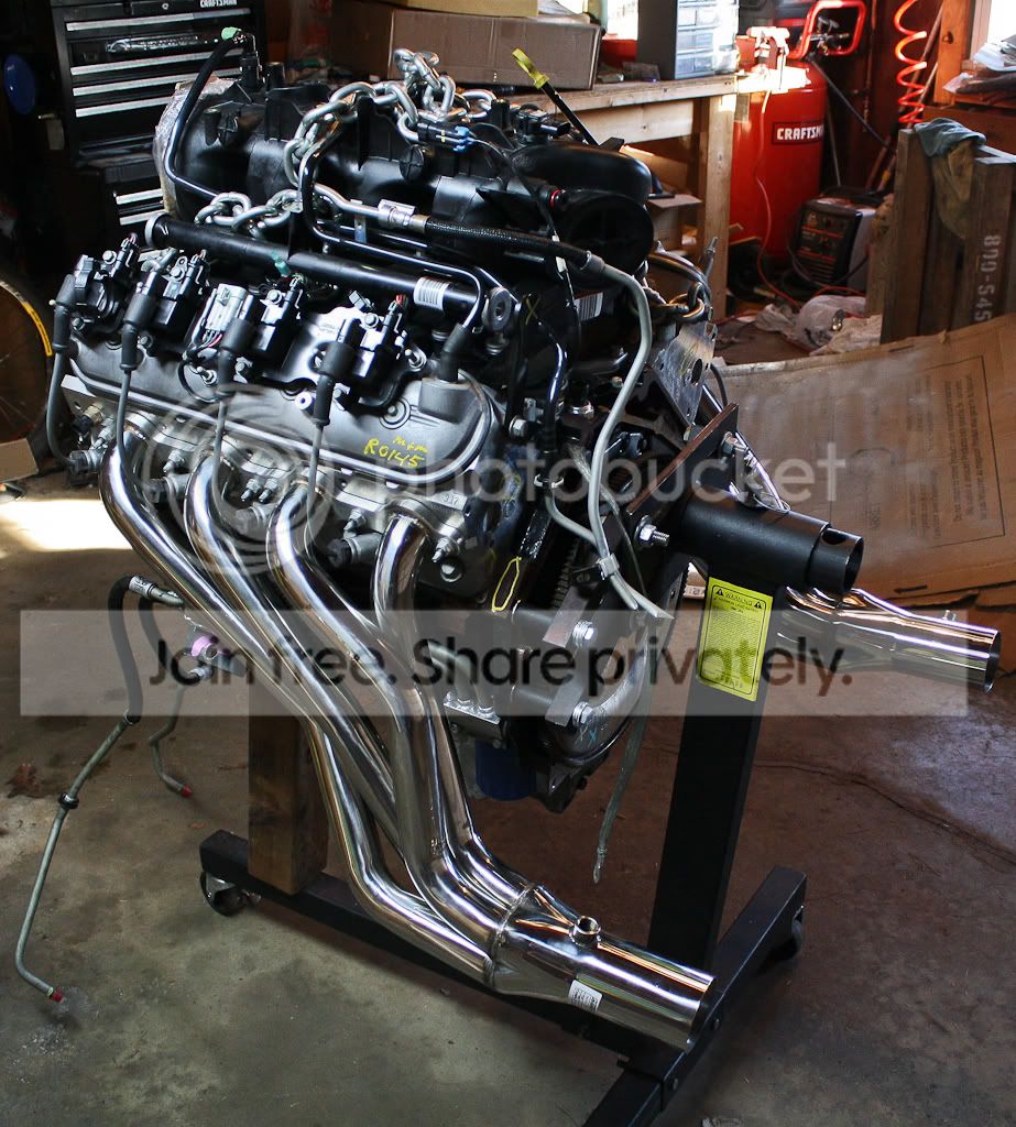

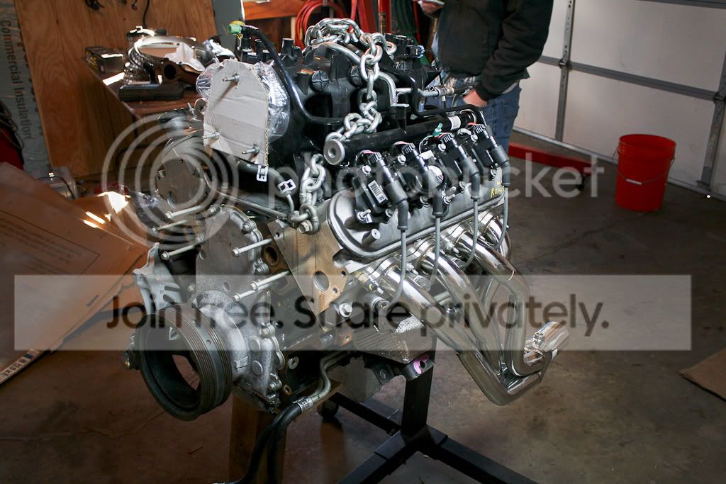

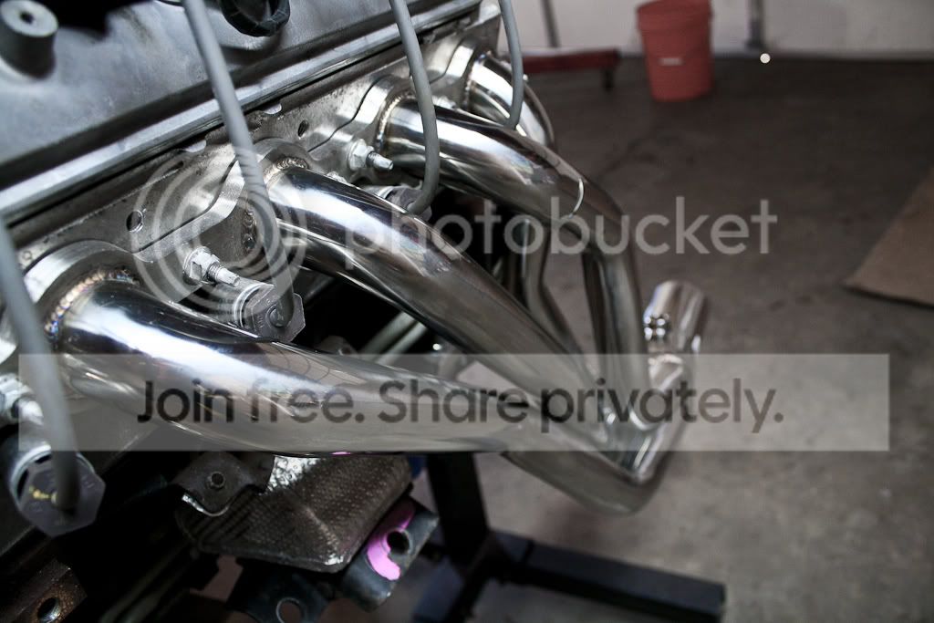

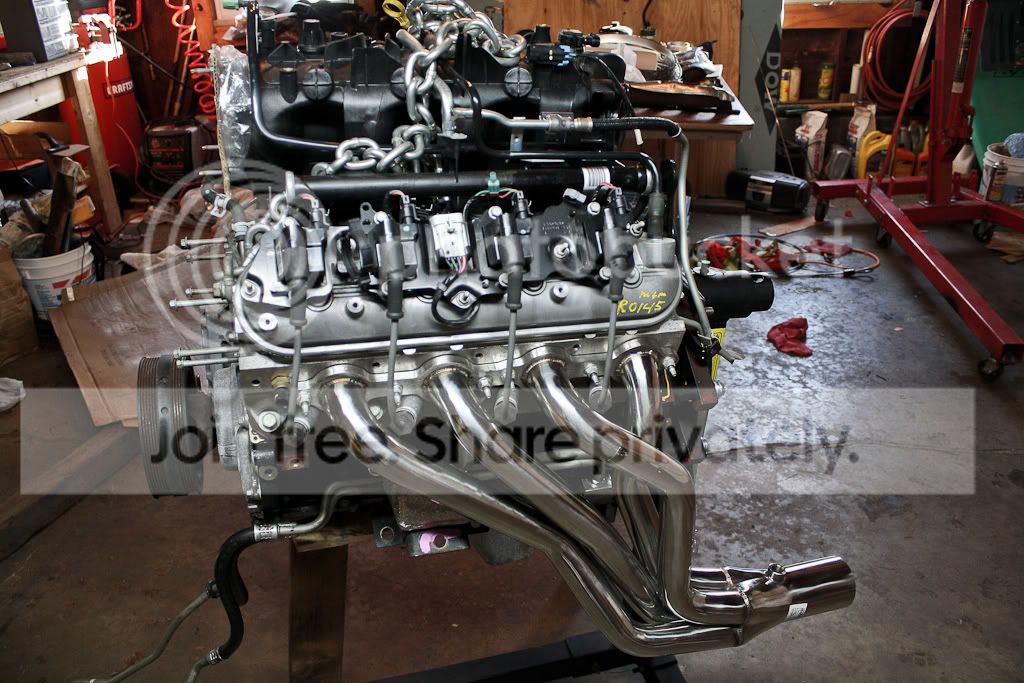

I made the thread for the headers, but never updated this.

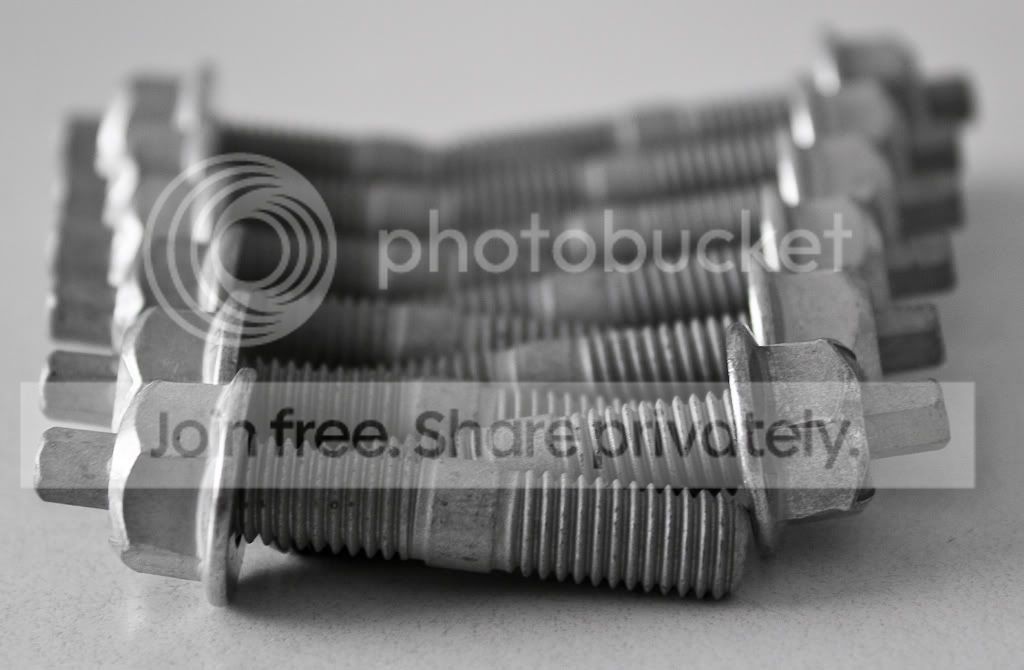

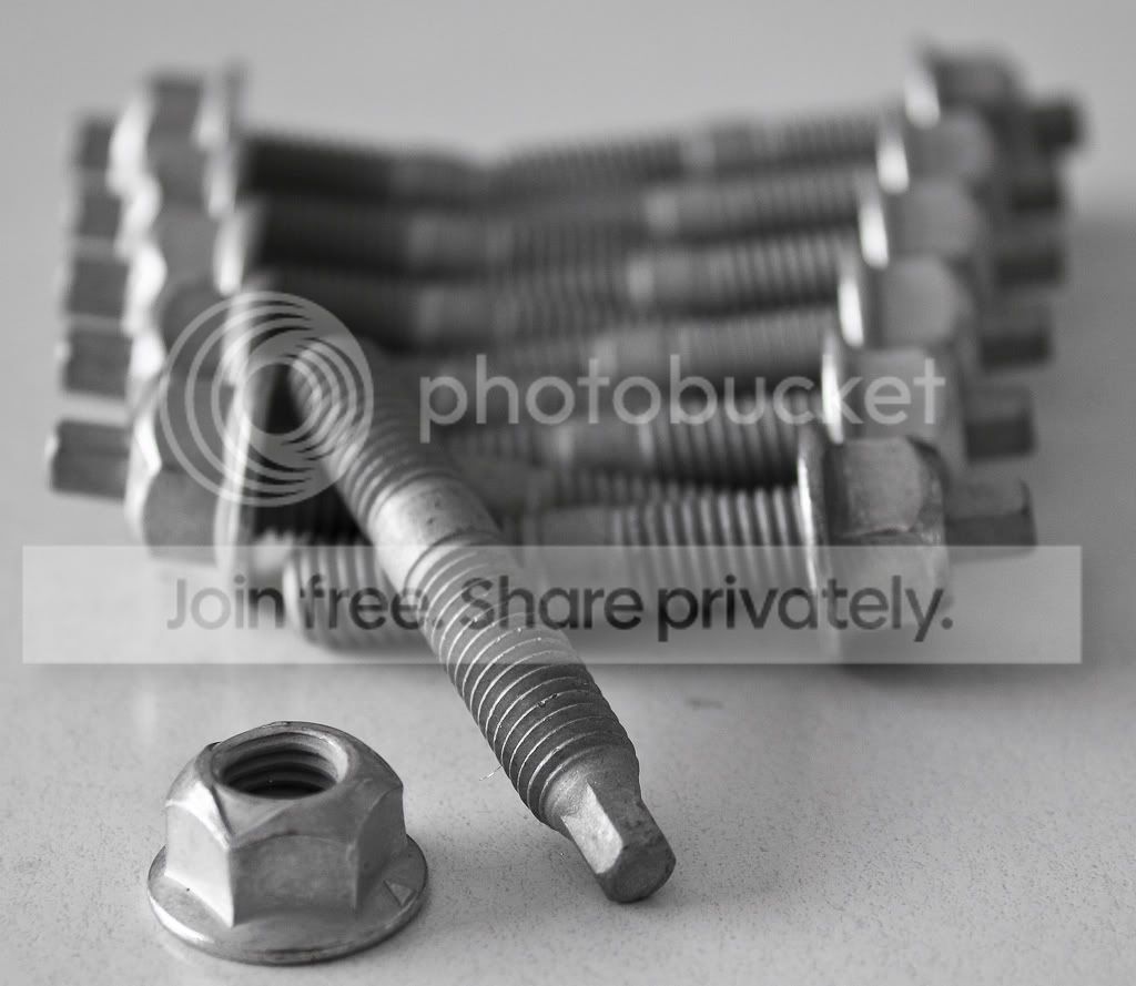

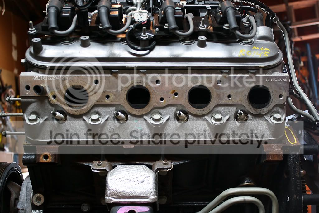

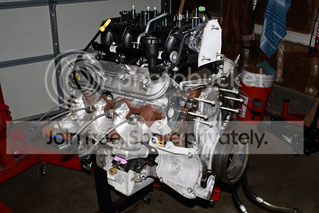

Instead of using the OEM manifold bolts which are notorious for having the bolt heads pop off, and for snapping during removal, I decided to get some GM manifold/header studs. I think they're an OEM part on some V6, but I'm not sure.
The part numbers:
11589154 for the studs (come in packs of 5, we need 12 total)
11609746 for the locking nuts (come in packs of 4, again, we need 12).
The studs:
You can kind of see the triangle shape of the threads in that second picture, that's how the nuts lock.
Manifold off.
Studs in.
I re-used my stock gaskets, since they were still in good shape. Another big advantage to the studs, is how easy it is to align everything when installing.
Manifold on right, LT on left (duh). One's a little bigger, I think... :lol:
AWWWWW YEEEEAAAHH!

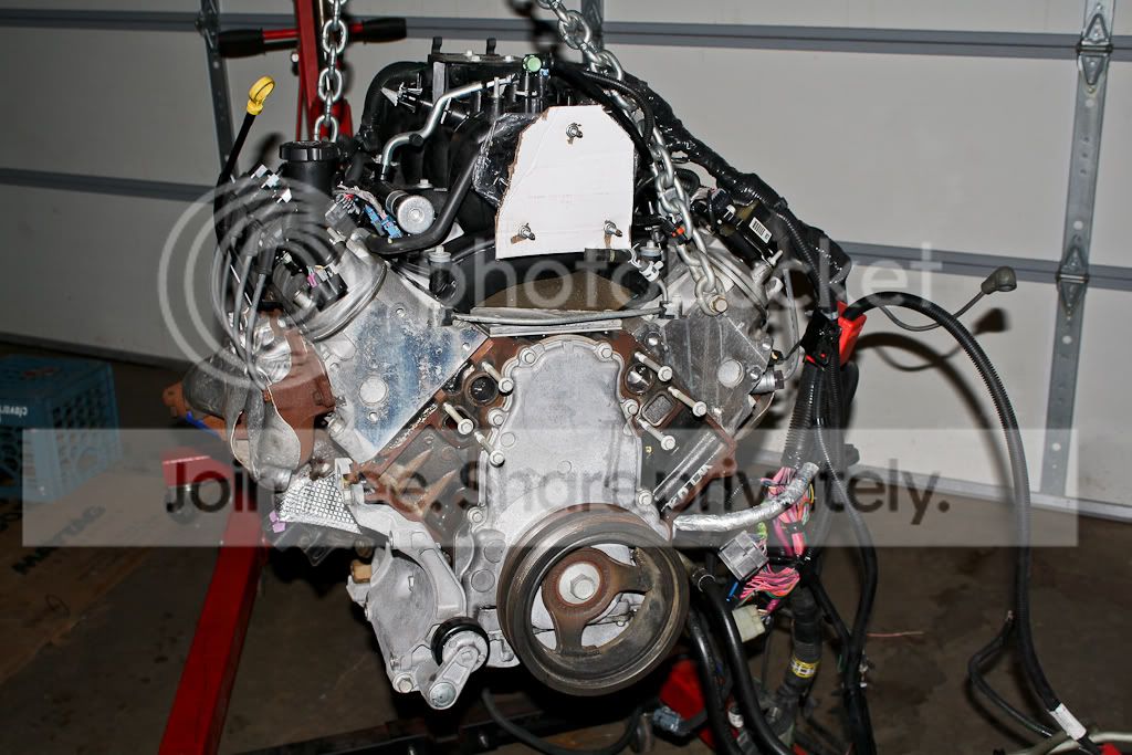

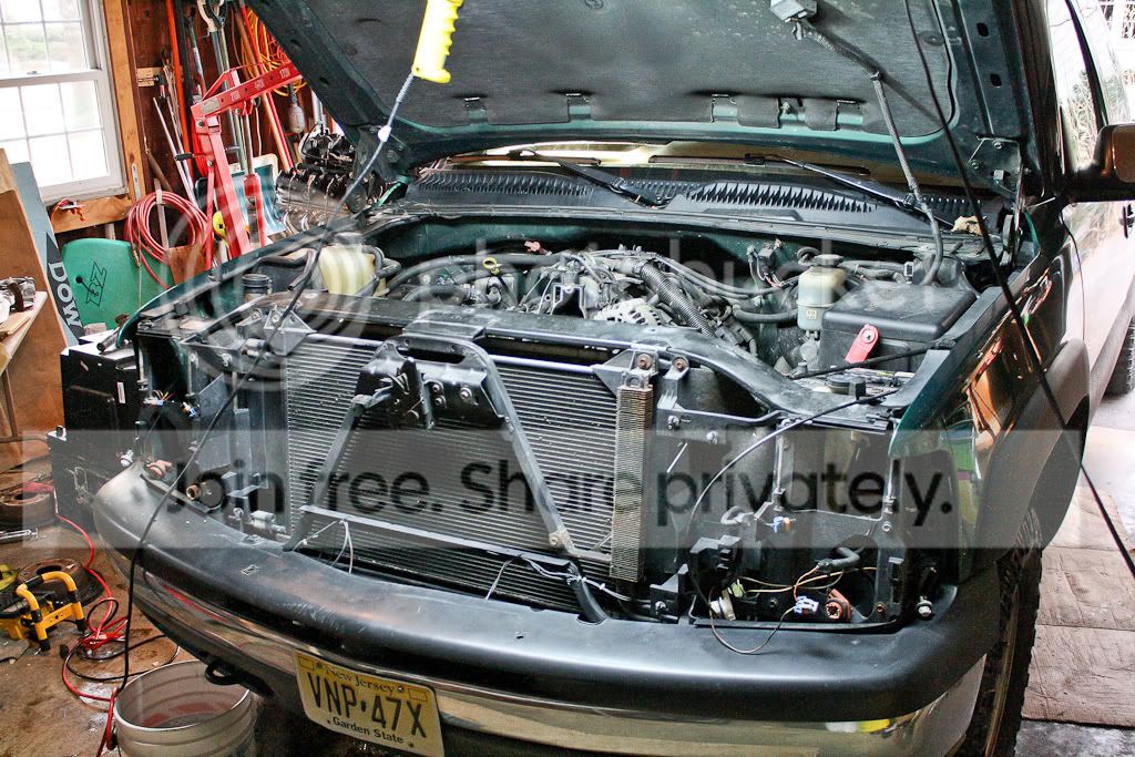

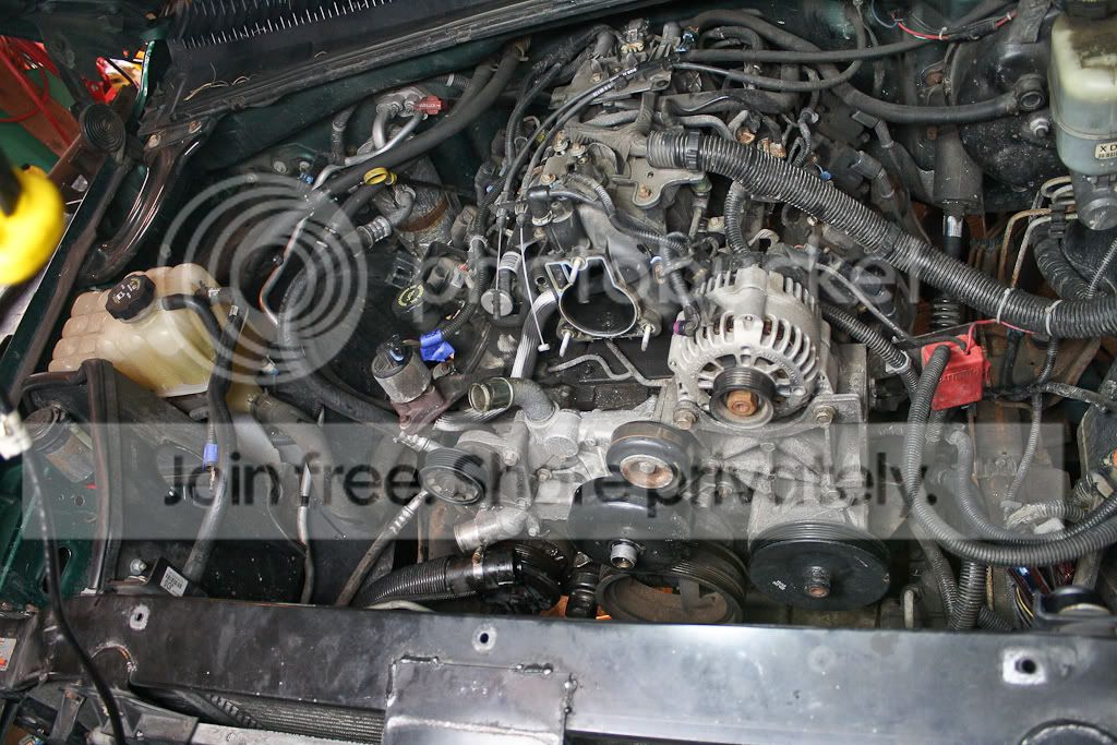

Just realized I never updated this thread. Bear with me here guys, I'm just moving everything into here so it'll be complete.

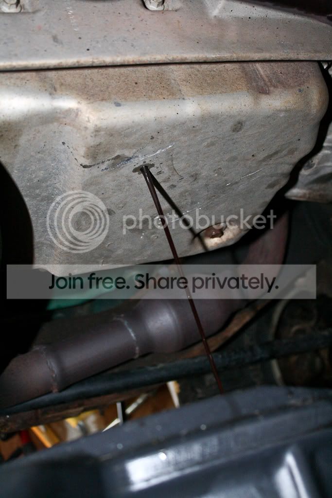

Got coolant and oil drained, coolant hoses all disconnected, fan and shroud off, TB off, probably some other things, but I'm in too much of a rush to think of them.
